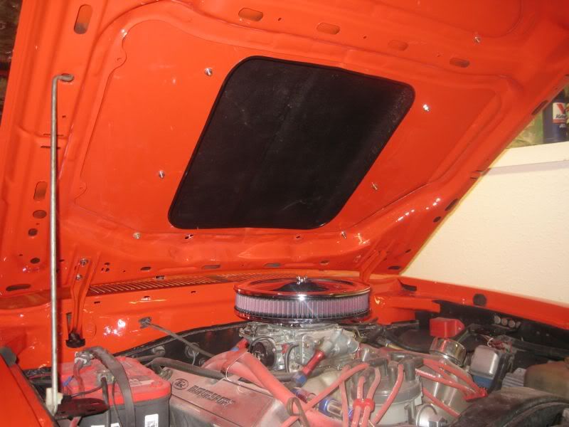

1976-77 Cobra II's had the scoop facing forward. 1977 1/2-78 Cobra II's, and King Cobras, had it facing backwards. I've seen many scoops turned the opposite direction from which they were produced, it's all a matter of preference.
If your car still has the correct '78 hood on it, there is a specific place in the hood to drill the holes closest to the cowl. It's hard to see, but look closely in this photo:
The holes for the original hood scoop are still present, in a flat, round area that cuts into the hood support structure. The '78 hood was modified from the '75-77 version to allow for this.
